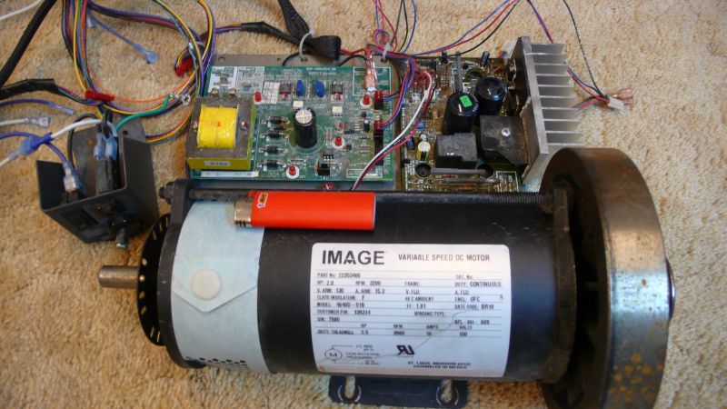

If you can get a motorbike with a dead engine cheap, and a treadmill motor (3kW with not much of a fan) cheap, throw in some free "dead" car batteries and see how it does. 3kW will get you.. 78km/hour or so?

I got 31 MPG driving five miles per day, not exceeding 40mph, hitting approximately 12 stop signs per day, 6 days a week, for 2 years.
in a 1996 honda civic that i drove into the ground.
the 300wh number is for an SUV conversion, 100kva motor, average driving, actual case study numbers from 2006 or so.
I'd give you as low as 150 wh/mile for a purpose built hybrid, daily commuter, say 3000 pounds.
50wh? you're talking electric motor cycles there...
