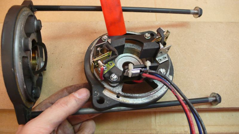

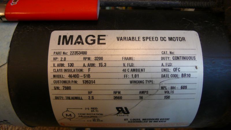

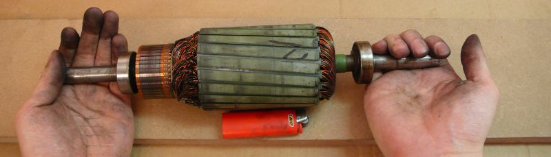

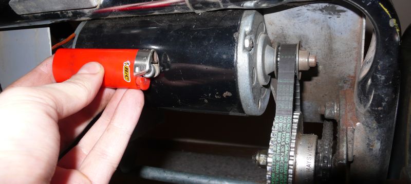

These are the two DC motors I have available right now:
Here's the 12V (14 really) one, something said it was 45A (almost 1hp), or maybe that was just the controller. It's the size of a wine bottle (the cylinder part before the neck):
user posted image
I didn't really want to use this, since it's from a functional unit (motorized golf caddy). So, to ease my conscience I made a fair attempt to sell it on craigslist for $500. In February. In Canada. The night before Valentine's day. Listing and picture. Oddly no one even made an offer so my guilt is vanquished.

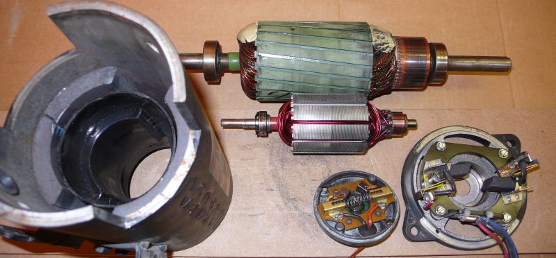

Here's the bigger one. I took the flywheel off and inspected the innards. It's probably way too big to mount on a bicycle, it wouldn't fit anywhere comfortably, too wide to be between the knees and I don't want a chain going all the way to the cargo rack. Might suffice for the motorbike. Don't know if it actually works, should test that:
user posted image
user posted image
Don't know if there's any wear on it:
user posted image
Why 4 wires? What do those blue ones that are going to that silver thing (only) do?:
user posted image

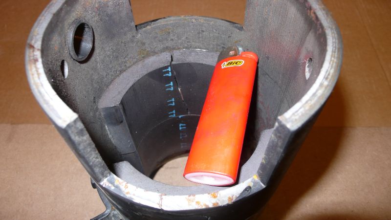

Hrm. Is it supposed to have that crack in it? Seems it was there pre-sale, since there's something shoved in the gap:
user posted image

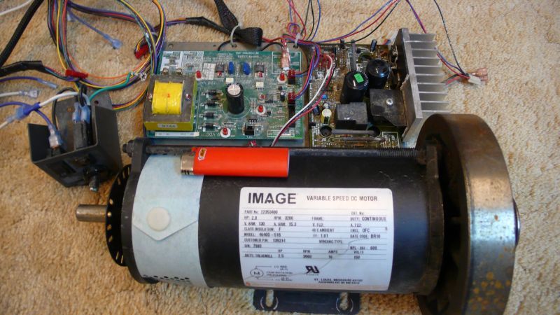

I yanked the controller out of the treadmill too, but it's black magic to me. I might as well build my own. It did have a disk with holes and a transistor to measure the speed though.

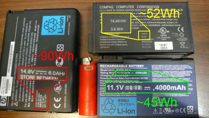

Here are some laptop lithium ion packs, with their voltages and amp-hour ratings (Volts * Amphours = Watthours):
user posted image
Great, so, 450 watt hours would be about 5 of that big pack on the left. (It's about the size of a CD case and a bit more than 1/2" thick, 3/4" including all the plastic casing). These could easily fit 2-wide inside the triangle frame somewhere and there's lots of room for them.
I like the idea of putting them underneath the cargo rack (hidden by the paniers and no weight going on top of them).. so a 6-pack of 2 deep would fit easy, and 3 high would only take up about 2". That'd give me 550 watt hours, enough to account for motor losses perhaps.
They weigh around a pound each. So, that's only 6 pounds. If I wanted to double my range (to 60 miles/100km) at that speed and sit on my ass for 2 hours, I'd only need a dozen packs, 4" tall, 12 pounds. That would get me almost indefinite motoring when touring, as I'd want to get off at least every 2 hours anyway and towns often aren't 100+ km apart.
Same battery pack traveling at my speed (25km/hour) would give me a 9 hour, 225km (135 mile) range. Without me touching the pedals. More than 2x the range but takes me 4.5 times as long. Of course if I was pedaling and adding 100watts of power, I'd be going 36km/hour, and would cover 325 km (200 miles) in a day. If I could pedal for 9 hours. 5 is probably my max.
For the big bike though.. at 80km/hour I'm soaking up 1800 watts. That's 20 packs (2 long x ~6" high) in an hour to go 80km.
This is becoming numberspam so I'll stop. I could graph this to show the penalty of speed but I'm lazy. Might later.
Bottom line is, at bicycle speeds, a rather tiny and light battery pack can yield enormous ranges (for a bicycle).

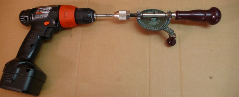

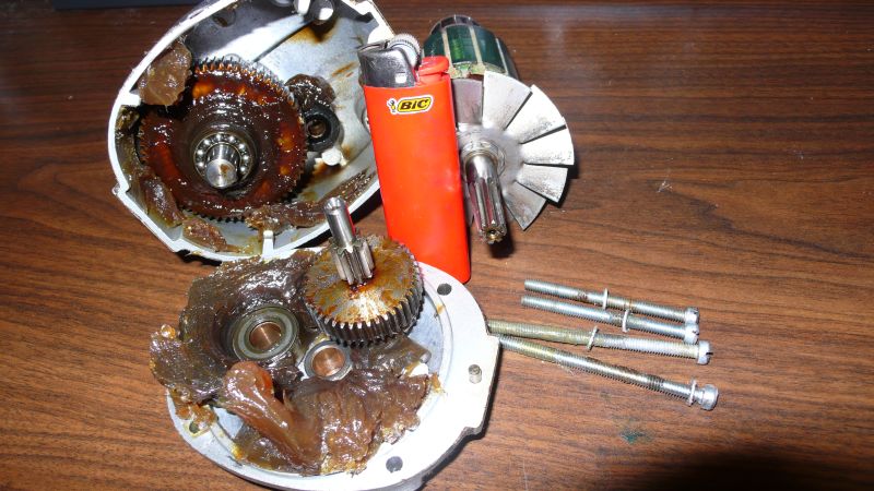

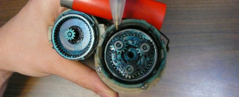

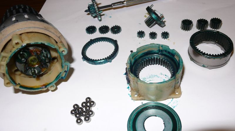

I discovered a fun idea the other day:
user posted image
Two drills = E-Bike.
The battery powered drill gears down to a decent speed. A metal bar to couple them (they both have keyless chucks), and then the hand drill gears it down a bunch more and changes the direction of rotation 90 degrees.
The resulting cadence of the drill crank is almost exactly matched to the ~80 RPM biking speed.
Drill a hole through the big gear, screw/weld that to the crank sprockets, mount the extra dummy gear on the far side (or ignore it completely)... and then hose clamp the whole thing to the seat post on a bike. Instant E-Bike. (Though you'd have a hand down around your groin to hold the trigger). I think I paid $5 for the pair.
Get rid of most of the electric drill and replace with a bigger motor, add a trigger, that's pretty damned close to a complete (if rudimentary) E-bike.
I'll shut up now.

The cracked(?) magnet looks well-dodgy to me..... that bit in the gap could have been pulled there by the magnetic field....
Have you taken into consideration the effect of a body on the rolling (wind) resistance? Consider a 'low-rider' version (aka Sinclair C5 but with looks and performance... laugh.gif )
Weight is always the killer. Find a frame/wheel combo that's as light as possible.
Use the bigger of the two motors - spare power is great when you need it.
Blue wire/silver thing is probably a speed sensor, possibly a temperature sensor.

QUOTE
It's not magnetic, it's like, a folded over cardboard shim or something. I'm almost certain it got sandwiched in there when it was built. Meaning the assembler knew damned well it was cracked.

Speaking of geardowns being insufficient... double-posting to take/add more pictures, 'cause, project threads are useless without pictures:
18V cordless drill with high/low speed gearing (lifts the extra ring gear):
user posted image
Pretty puny despite being a fairly big cordless drill. Note the size of the shaft on that little motor. Not even as thick as the ballpoint on the pen.
Hrm. Maybe a corded drill will have beefier gears? Let's see what I have laying around... how about this one (1/2 hp)?:
user posted image
Yeah, that looks better. Let's have a peek inside:
user posted image
Well, the 3/8" motor shaft to start off with is certainly more encouraging.
Side by side:
user posted image
Yep, it's definitely larger.
But neither are anywhere close to the size of either of the drive motors I planned on using. Problem?

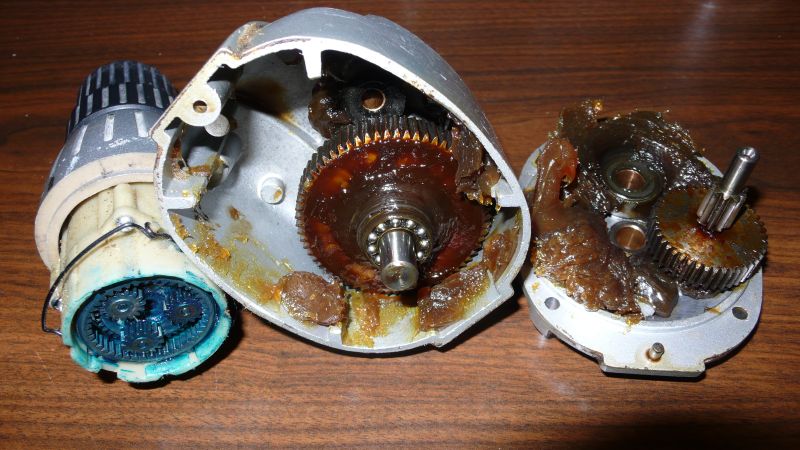

Ever wonder what's deeper inside a cordless drill's planetary gears? Well I did. Took pics 'cause, why not:
user posted image
Arranged in columns per layer.
Holy crap I had no idea there were so many gears. 3 sets of 5.
There's a layer of ball bearings to hold the last ring gear and then there must be a lower set of bearings too 'cause it still glides below that. Couldn't take it apart any further, which was a bit of a pain in the ass since I don't really need the chuck. It's extra convenient for a quick setup, but it's an extra pound or so and several more inches that I don't need if I could just couple to the shaft directly.
Contrast this to the 3 big gears (one dual-ratio gear) on the older 120V drill gearbox, which, I counted, does about a 1:38 geardown.
I don't know what the starting RPMs are for either of the motors and I couldn't count the little one's ratio either. It's possible that they're drastically different starting speeds to end up at a similar result.
PMEmail Poster

Those are planetary gears, which always have greater gear counts.
None of those gears with the exception of the big drill are heavy enough. The smaller sets would overheat & fry within not too many minutes under that kind of load.
You might be better off locating a worm gearbox...they are quite common, & using the bare gears with axially mounted motor...the motor shaft parallel to the bike's direction of travel. Any gearbox with the input & output shafts at 90° to one another, & a ration higher than ~4:1 will likely be worm geared. This can be confirmed by trying to turn the output shaft. This should be difficult to impossible, even with a large wrench. The input shaft should turn freely & without perceptible side or end motion.
The gear would be mounted directly to the wheel, & the worm mounted to an extension shaft from the motor. You would have to arrange to tilt the motor so the worm loses contact with the gear for freewheeling...worm gearing is self locking othewise. This doesn't mean it'll instantly lock upon removal of power, but it will mean rapid decelleration, much like compression braking(NOT breaking) in a car with a standard tranny.
The advantage to this is only two moving parts. The disadvantage would be keeping it lubricated & consequent short lifespan.
There are very few options open for power transmission. About the only other simple system is to use a friction roller on the back tire, with the shafts of both motor & wheel parallel. I've done this several times with gas engines & it works well, except that it's awfully hard on tires. I've seen people using hocky pucks with holes drilled in them as friction rollers.
Having spent many years modding & riding powered bicycles, you can bet that your pedals won't see much use, because the extra weight will make pedaling cumbersome, to say the least.
BTW: Did you notice just how little of the grease in the gearbox of that big drill is still in contact with the gears? This shows why grease isn't the best lubricant for gearboxes...petroleum jelly is much better, because it's thinner & tends to cling to gears instead of being pushed away from them.

QUOTE
Yeah I'm familiar with planetaries. The mech I was working on in Cali had a set of 2 of them, 3' (yes feet) tall on each hip for the walking mechanism.
QUOTE
You'd think that the drill being, at least a few hundred watts, could withstand a few hundred watts, but, I guess it is a portable drill. I would have figured the weakest link would be the motor melting and that the gears would hold up okay. Oh well, different project.
I can get drills fairly cheap or free. Planetaries give great geardowns in a tiny package but I haven't seen any on anything other than cordless drills so they'll all be about the same size. I guess I'll just go with the bigger drill.

Started thinking about where to mount the big motor, if I was going to try it on the little bike. Then I came to my senses. It's gigantic. The steel case itself is 1/4" thick.
So then I took apart the smaller motor.
The outer casing actually fit completely inside the bigger motor's (with quite a tug, duh, several pounds of magnets, not sure how easy it's going to be out of there). Here they are side-by-side:
user posted image
Big motor is 20 pounds. Little motor is 4-5 pounds.
Big motor is 1800 watts. Little motor, if it scales, should be 360-450 watts. Maybe it's only a 1/2 hp. sad.gif
That's seeming a bit puny right now. Kind of wish I had something in between the two, but maybe it can be overdriven a touch. Especially since it'll have air blowing over it constantly.
Can't tell how worn the brushes are, but they seem to have plenty left on them.
