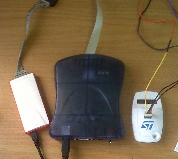

and here is a selection of ICSP/STMS Programmers in the dev workshop, If memory serves we have ~ 10 different programmers in total, (including a BIG 48 pin EEPROM programmer)..
user posted image
Left: Renesas (E8a) 12 pin (Min required - 7)
Mid: AVR (ATJTAGICE2) 10 pin (Min required - 5) (the ribbon cable is actually 20 pin, but every second line is connected to GND for signal seperation)
Right: ST (ST-Link/v2) 20 pin (Min required - 4)
